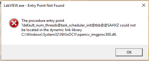

I am using labview 2014 sp1 32bit.
My operating system is Window10 64 bit.
I recently installed opencv toolkit using VIPM  (Run as administrator).
After installing and restarting PC, I tried to  open opencv example vi and i am getting following error.OPENCV ERROR.png
How can  I rectify this error.

Sounds like a Microsoft Visual C Runtime version error. You will have to find out which Microsoft Visual C runtime redistributable you need to install. Sorry to not be able to give you more specific information but I haven't used that library yet so not sure what is the Visual C version used for those DLLs.

There is a suspicious problem in your message. You use LabVIEW 32 bit on Windows 64 Bit. As such I would expect the system DLLs to be loaded from inside C:\Windows\SysWOW64 and not C:\Windows\System32!
Also did you happen to restart the computer after you installed this package?

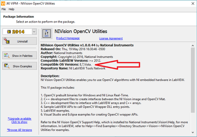

Previously i was working with window 8 64 bit  system and labview 32 bit was installed with opencv toolkit.  it was working fine.Now shifted to new system with window 10.
I tried with latest version of opencv tool kit and previous version also.
In vimp it is showing compatible os for toolkit  is window8,7 and vista.
Is it because of window 10 not supported?
 Nisarg Shah

You are right that system dll should be loaded from C:\Windows\SysWOW64.
I have checked all required dll are there in C:\Windows\SysWOW64. and not in C:\Windows\System32

Don't start copying and pasting DLLs from one system location to another. That only can make things worse if you don't know exactly what you are doing, and not even I would know how that could help in this instance.
I did briefly check and the installation procedure is adding these directories in System32 as soft links to the real installation (hence the administrator requirements for VIPM since you are not allowed to create symlinks in the system directory without. Also directory redirection in Windows should redirect to C:\Windows\SysWOW64 anyways when a 32 bit application requires a DLL in C:\Windows\System32 on a 64 Bit Windows system. So the location "should" be not the culprit.
Most likely your Windows system doesn't have the right Microsoft Visual C 12.0 C runtime libraries installed. Try to download this installer (for other people coming across this page look on this site for links for other VC versions) and install it on your system and keep your fingers crossed. Smiley LOL
This has most likely nothing to do with Windows 10 directly other than that every Windows version comes with a number of preinstalled Visual C runtime libraries for various build in components that were created using various versions of Visual C. If your library happens to use the same version of Visual C as one of those built in tools was created with it will work, otherwise Windows will not be able to locate the prefered version for your DLL and will try to load with another similar one, which often ends up not having the required exports.
