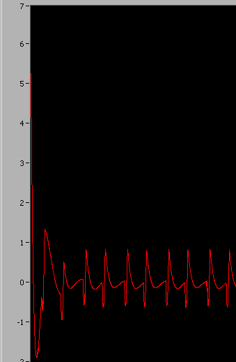

Good morning kmous,
I ran the VI with the data you provided and repeated the sample within the while loop.
I had it on Highlight execution to see if it went into the correct case, which it did (based on the EMG or Force selection).
Below is the resulting waveform.  I Edited the message to include the 2nd one, which has the line... I cancelled the load data to stop the VI, thus resulting in the +5 signal.

where the line coming from ? I did not get that when i ran it on friday!!!!

I was getting this waveform as well..  the negative one..
Go through the array of channels and make sure that you only have two selected as active.  Run it again.  You should get the same one as what I posted this morning.
By the way, try posting the image as a png and not a gif.  It will be much smaller.
I would not worry about the line (for now).  I will look into it tonight.
