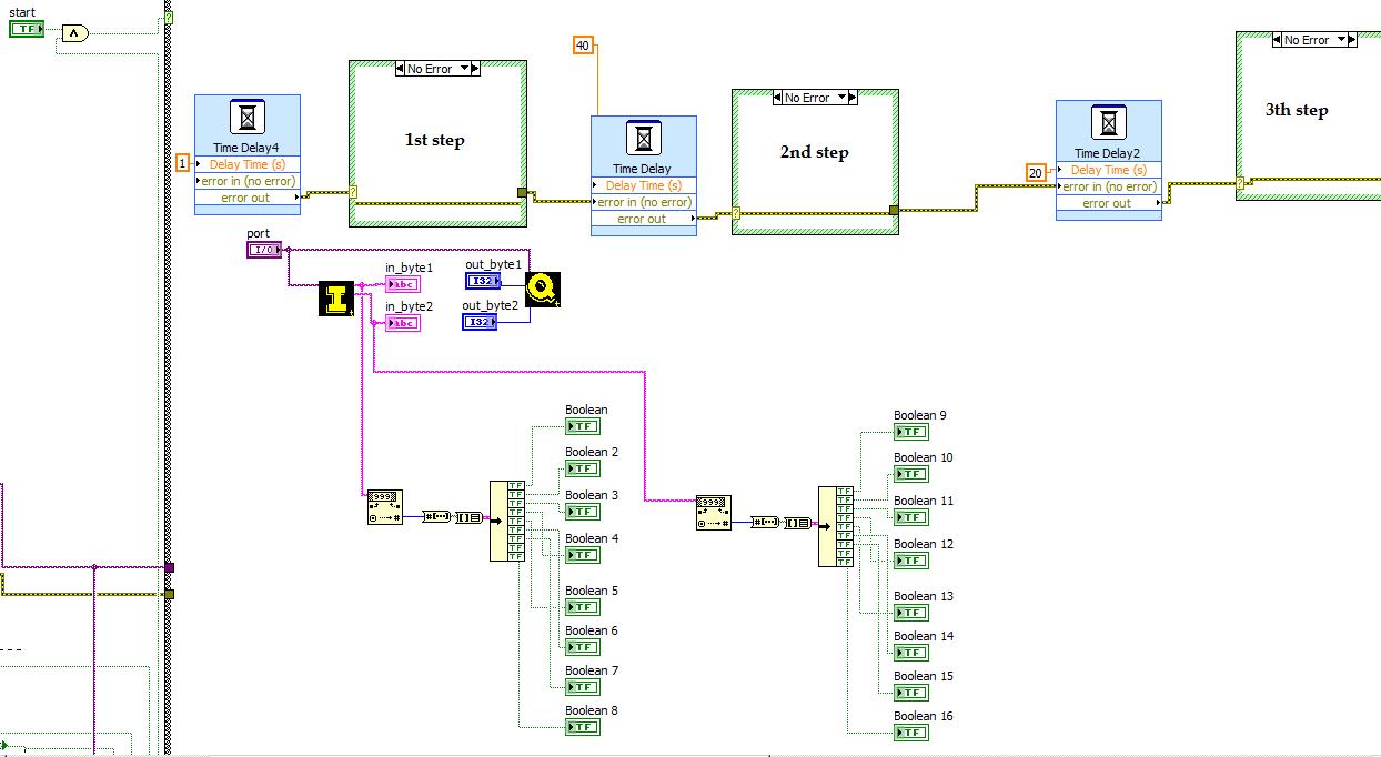

i had to use a sequence like this, and all this case is located in a while loop.
when the user clicks the start button, the sequence steps executes one time.
i used the error lines to ensure the same linear execution.
the booleans are used in the steps. but as i said, i can not get the online data from the module because of the delays.
the delays are necessary because the product we are testing needs them.
for exp it becomes ready 40 secs after power-up.
but i need to read the inputs during this time too.(for exp for the stop button, emg stop, ect)
i would be pleased if you could give me some advice about this.
thanks.

Hi tonay,
the standard recommendation for such cases also applies here: use a state machine and a parallel loop for the GUI handling!
In the picture you show 3 execution states plus a "wait" state between them. Make a state machine with a case for each state. For the wait state I would use a loop with only a short wait to enable fast reaction to GUI events...
And please replace that boolean array to cluster to unbundle by one simple index array function (RubeGoldberg)!
Message Edited by GerdW on 07-28-2009 02:00 PM
