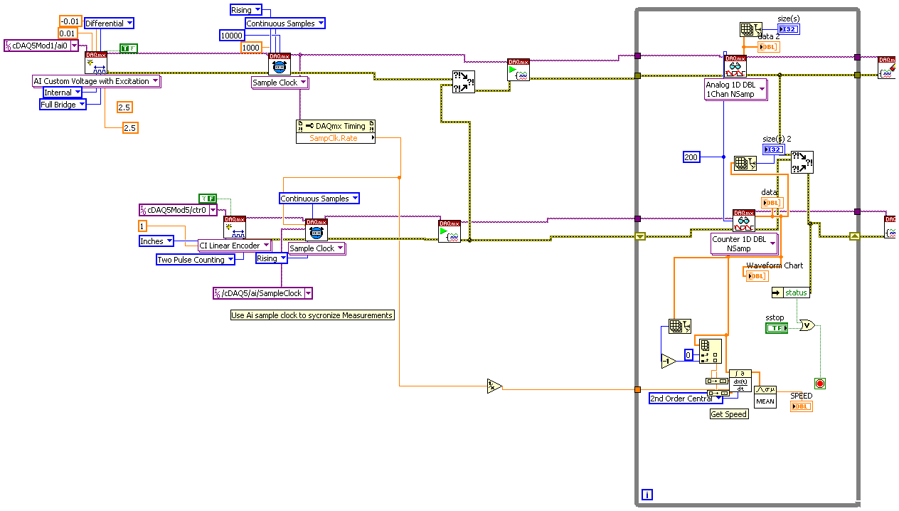

I had an application similar to that.
I just used one while loop and sychronized the analog input clock to take a measurement on every clock pulse.  This worked very well.
This is the messy version of the code but it showed what I did.

I forgot to mention for this to work you need to remove the duplicate counter measurements.  I used an OpenG VI
In this example I was only interested when the counter changed.  You also need to sample faster than what your encoder.  This method might not work for really fast applications.

Hi ASTDan - thanks for your reply
I am trying to figure out how exactly i would incorporate you idea into my vi - of which i have attached the picture.

You can't have 2 instances of Analog input.  You need to have only 1 instance of an analog input task and then read N Channels N samples for your analog read.  Then index the analog input channels you want.  That I beleive is the -50103 error.
The other error can be caused by highlight excution being on.  It is basiclly saying your buffer is full.  You need to read the data out of the buffer faster.  I think you will run into this with highlight excution being off because you are only reading 1 point out of the buffer/while loop interation.  I would recomend reading more samples/iteration.
