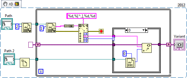

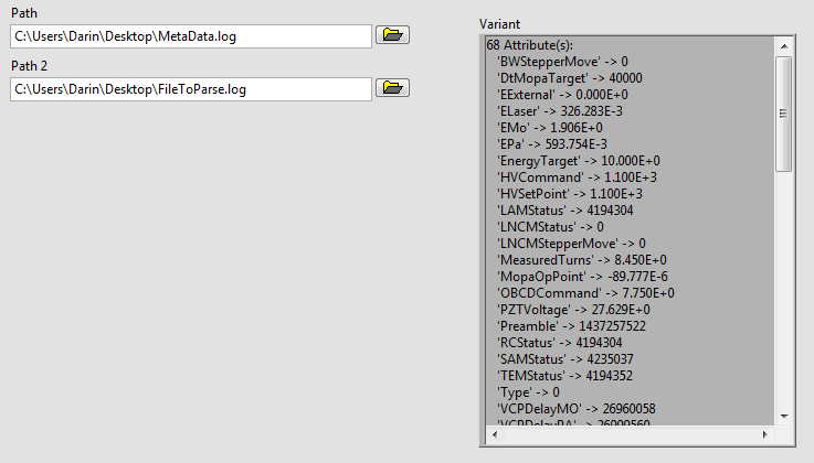

This is the kind of thing I would normally be slapping into a database, especially since it appears that you have a fixed set of fields that you choose from.  Short of that, and without know what you want to do with the data other than read it, I would probably next go with a variant.
Your fields end up as variant attributes which you can then look up by name.  Still some work to decide how you want the data, you could promote all of them to DBL (makes things bigger), you could use strings (bigger and some ambiguity with floats).

I'm going to try your solution by recreating the block diagram. Is there anyway you can upload that code snippet as a .vi?
Message 6 of 9
(4,307 Views)
He already posted it as a snippet.  Save the block diagram image to your computer.  Then drag the file onto a new block diagram.  Instant code.
Message 7 of 9
(4,303 Views)
Ok, that works pretty well for creating the variant, but how can use this variant to read the rest of the file? I want to end up with usable data for all 2500 chunks.
