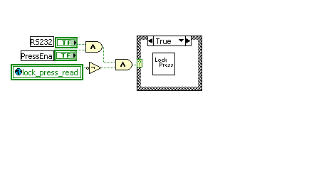

part of a bigger code
krispiekream wrote:
i see in the codes that the inside true case is used quiet often somewhere else in the code.
how about creating a subvi for that?
would that be a good idea?
It is always a good idea to wrap often used code into a subVI.
krispiekream wrote:
i dont know if it would considering that we have to have local variables in and out of the subvi.
I have no idea what you mean by that sentence. Please explain, maybe with an example.

-----It is always a good idea to wrap often used code into a subVI.-----
hmmm, okay, how would i make a subvi of the stacked sequence? can you show me an example. i am not fimaliar with it.
i made this.
can you tell me if it is correct. i hope i didnt break anything.
Message Edited by krispiekream on 06-11-2008 01:32 PM
Message Edited by krispiekream on 06-11-2008 01:33 PM

here is the reason why i think i should create a subvi? this part is used quite often in lots of places of this code.
can someone tell me/show me to do this without breaking anything. thanks

You reaaly should spend some more time on tutorials.
In this case you could create a subVI with minimally the following terminal connectors:
  • Pressure array input (this replaces the local variable read)
  • Pressure array output (this replaces the local variabel write)
  • Current pressure output
  • Error Input
  • error output
Try it! 🙂
Message 15 of 17
(1,218 Views)
 i dont understand this
  • how would i do it?
