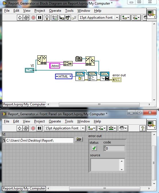

I’ve been working on a quite big project for my university and they would like a report of some kind of the project. This should be more of a documentation of the project. So my thought was to use the report functions to create html-files for the VI’s in the project. One part of the html-file would be the list of subVI used by each VI. This is where I run into problems. I get the list of subVI’s but don’t get the icons.
The following code:

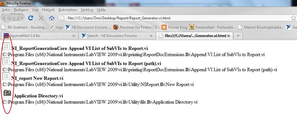

Generates the following html-page:

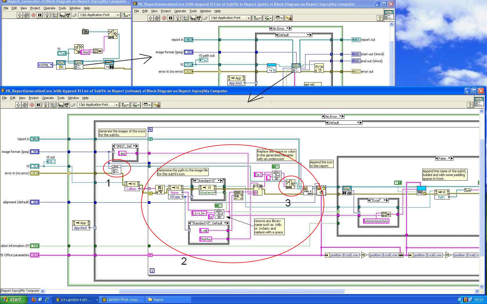

Notice how the image links are broken. After investigating the report VI’s I found some problems with the code in a lower level. Opening up the subVI’s as follow:
20479i64D64C88BE7127B2
The problem seems to be that the structure on filenames differs from the function creating the icon picture (marked as 1), and the function writing them to the report (marked as 2).
Filename’s on image’s created at point 1
Filename’s being append to htlm-file at point 3
Notice how they differ with double underscore’s after NI on the real image files.
I think this is something that should be corrected.
