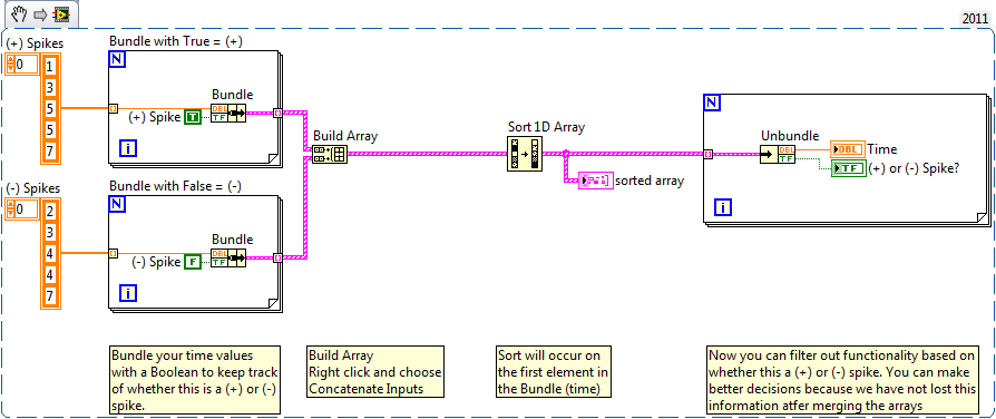

Thanks for looking at it.  I will try using some simulated data.  My major concern is in the part of the program that counts events with both + and - parts to them - I am a little worried that this may be overestimated if there are several peaks of one kind (say + peaks) within 1 msec of each other because I have the time of peak data from both the + peaks and - peaks combined into an array and then sorted ascending and this doesn't take into account whether the peaks are + or -.  Is there a way to assign some kind of value or index to each time of peak value to ensure they are looked at singly?

The main issue you are running into is merging the (+) and (-) peak arrays. When you do so, you can no longer tell whether the item is a (+) or (-) peak.
We need some way of saving this information, and then still being able to sort. This can be done by Bundling the Double value with a Boolean, then applying the sort. After the sort, we will still know whether it is a (+) or (-) peak based on the Boolean Value.
