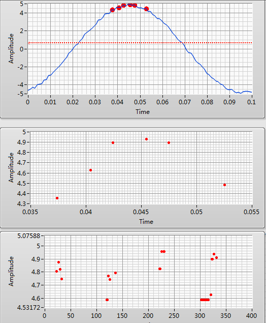

why the results is different between waveform peak detection and  Peak Detector PtByPt VI? the signal source and threshold and width is the same.

Hi frogliang,
Because of your programming!
No, wrong!
The PeakDetector analyzed ALL samples, while the PtByPt-function only analyzes the first sample of each data block - as you have programmed it!
- What's the reason to use a PtByPt-Queue in your VI? Why is it needed?
- Why do you use DAQmxRead in "N chan N samp" mode when you only read one (1) channel?
- Why do those graphs still have no label? Don't you listen to advice?

Hi GerdW,
I want to collect all the peaks, I thought the function is giving a "ture" when there is a peak detected. so every time it detect a new peak, I put the value to the array.
So sorry, I didn't quite understand this, but only N chan show a corresponding signal on the graph when I connect to the real signal.
I really appreciate your advice, but I planed to do that in the final step.
Could you please explain more in detail? below, the first two is show by PEAKDETECTOR of each 100 samples, the last one is  PtByPt of 1  to 400 samples. It seems that the PtByPt has different detect value during each data block.

Hi Liang,
But you have wired the waveform coming from DAQmxRead into that Queue function - which makes NO sense at all…
You planned to keep a VI where controls/indicators have NO label?
Have you ever programmed using a text-based programming language? Did you program the same way: give variables a label just as final step???
There is an IndexArray function just in front of the PtByPt-PeakDetector, which makes it work with just the first sample of each data block. Pretty senseless, don't you think?
Because it is working with very different data…

Hi GerdW,
When I us single channel, the wave is incorrect on the graph, and  myDAQ example also use multi channel, I don't get it.
If I use single channel, I can use get waveform component to get Y value, but multi channel can not. so I use queue function as the threshold example shows, and the index array is in the DAQ examples, use to transform to single point, otherwise the queue function  is useless. I got so confuse of the data type, I try this way to eliminate errors.
What should I use to make the input data source the same ?
