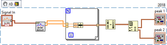

I have a signal with multiple peaks. I am interested to find the location of 1st and 2nd highest peak only.
Can anyone please help.
I have applied a derivative method then savitzky-Golay filter and then peak detection method on my input signal but i am getting many locations.
I only want 2 highest locations.
Attach is the screenshot of my VI and Front panel diagram.

Here is an idea ...
just sort the results by amplitude and pick the first two ...
Adding the bells ( at least two peaks? ) is your homework 😉
Why not posting the data? (Or a vi including the data ? Hint: Edit: Make current values default 😉 )

Thank you for your reply and suggestion.
But.. it didn't work for me. The method u suggested gives me highest value 10.70 and 2nd highest value 10.64. but on actual the second highest peak is on 15.53. i am interested in peak values where slope is zero not the side points.

First you should read the help files of the vis you are using 😉
peak search uses a fit approach and the parameters have influence on the result...
after you have a good guess of the two max peak positions, you can cut out an area around it and look for the maximum..
here I made something similar
