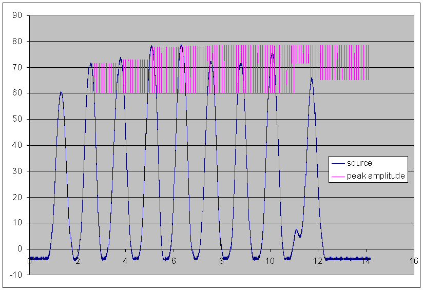

Thanks for the help guys.
I was able to get my results to record.  However, recording the peak amplitudes and graphing it are not correct (in pink)
Look like the timing or dt is off?  Cannot leave the dt empty so I tried using a constant for the dt, I've also tried using the amplitudes with an index array for dt.
Thanks for all your help!
Message Edited by immortalc on 06-22-2009 10:41 AM
Message 12 of 18
(2,211 Views)
I tried a waveform peak detection which is a different from my other vi. This new vi can change the width (sample size) to detect and record just the peaks.  with the advanced peak dector vi PtByPt, the samples were holding the peak values too long which was what i was seeing in my graphs. Everything is working now!
