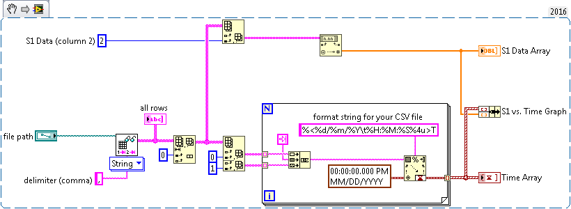

There probably are easier ways to extract the absolute time from the CSV file. But here is one way
p.s., I noticed that your Absolute time data is not always increasing constantly over time. There are several instances where the absolute time goes backwards by 0.1 sec.  Probably the way your operating system is obtaining the time. Your XY graph will look a little funny in these ranges. So your best way to display this data is what BowenM suggested, use a waveform graph, and assume your time constant dt = 0.001
