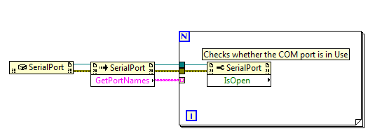

Hi El_Tipo,
 The scenario which you explain that "FindResources.vi is unable to find the resources (i.e. com port which hardware is using) when the port is disconnected and connected to another port during the run-time even though the device manager is updating" is very surprising.
  I am just suggesting you to use the System.Io.Ports .net class and you can try creating a vi which works similarly with FindResources.vi .I am just attached a picture which will act as a start..
SrikrishnaNF
Srikrishna

I have been browsing the .NET constructor and I have net been able to find the System.IO.Port
would it be normal if I happen to not have this on my machine?
If you could just send me the constructor that you posted on the picture it self and see if it is broken on my end or something it would be great.
Here are some pictures.
regards,
