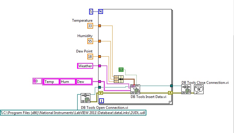

Hello again,
This figure is presented what I try to do using Labview & Microsoft Access. At the moment I took some random values for the data (in reality I will acquire the data from the sensors every 30 minutes). Firstly I created one empty database using Access. Then by the help of Labview I insert some data to this database. The communication that I used between an application and a database is UDL and the type of the datadase is mdb.

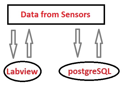

Now instead of Microsoft Access I would like to use PostgreSQL. When I try to make an empty database with postgreSQL I don't know where is located this database in order to search with Labview and in addition I don't know what type of database is. What is the modification that I need to do in order to work with postgreSQL???
I really need your help because I just start to use Labview with Database Connectivity toolkit and it is very new for me.Smiley Happy

If everything works as it should, you only need to reconfigure the .UDL. Just double click it and change the settings as needed.
I havn't worked with postgresql, but basic sql is a standard thus no need to change the code. 🙂
