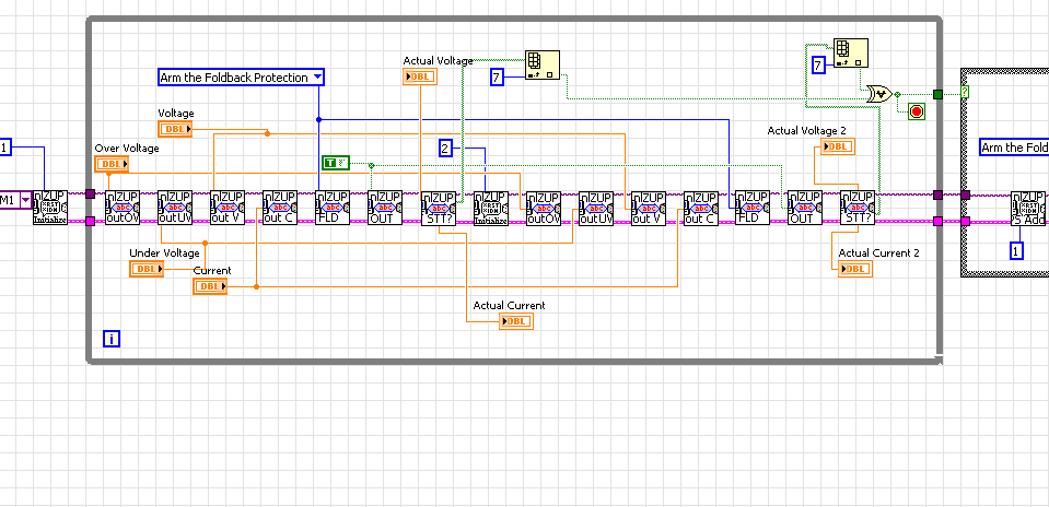

Hello dennis It is working fine. Thank you. One thing I noticed that I cannot give a loop for continuous monitoring. Oh sorry, I forgot to try the loop except case structure. The ex-or o/p we can connected to the loop stop and same o/p will go to the case structure selection. At the time of writing this, only I remembered this idea. Whatever it is working and the next part also will work. I am sure. What about you?

dennis
i am attaching my vi, p.ease go through this

It seems incredibly foolish to be repeatably doing all of the setup over and over again and I don't see why you are so insistent on using the exclusive or.
If you want to continuously monitor the fault condition, place just the status functions in a loop and probably in a separate loop after the initial setup and while you are doing other things. I'm assuming that the rest of your program could result in a fault condition after you have initially setup the supplies. If so, then definitely a separate monitor loop.
Also the alarm register does not have 8 elements if I remember correctly.
