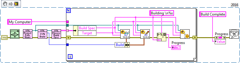

Hooovahh correctly found my Idea Exchange Post, where I "agree to disagree" with the NI guy who argues with me what "Pre-Build" means (I argue it means "Before the Build", not "After you start the Build, but before it really gets into it, in some way undefined ...".
I also implemented Hooovahh's "Build Twice, Run Once" (hmm, sounds familiar ...) technique, which I think I documented in the comments to my Idea.  The reason this became such a pain was that I was using it with a Project having 5-10 Builds, and wanted to use Build All, but didn't want to baby-sit each Build individually.
So the main thing that Build Right is doing is setting the Build Component of the Version specification to be the current Revision Number for the Project as registered by SVN.  I get this using the VI "SVN Build" that does a System Call on the Project using Tortoise's Subversion Working Copy Revision utility, and use the Get/Set Build Specification Version VIs to update this in the Version Spec (the other elements, Major, Minor, and Patch, are Constants of the Routine).
So the key idea here is the following:
  • I gather the "Global Data", the Project Path, the SVN Build, and give the User a choice of picking a Build Spec from a ListBox showing all of the Builds associated with the Project, or allowing the choice "Build All".
  • With the Array of Builds (possibly an Array of 1, if chosen from the List Box), update the Build part of the Version, tell the User what we're doing, then use the nice Build.vi to do the Build for me (once).  This works because I do the "Pre-Build Action" before I tell LabVIEW "Do a Build", so it really is "before the Build".
Here's what it looks like:
Bob Schor
