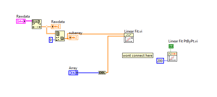

i am using labview 2010.
the linear fit ptbypt.vi will not connect to my array?
Krispiekream
Message 15 of 21
(2,050 Views)
Krispiekream
Message 16 of 21
(2,039 Views)
ptbypt VIs operate on singe points as they are measured and keep an internal history of recent points. read the help!
In the second image, the two array have different lenght and the error message tells you exactly that. No mystery there either. 😉
