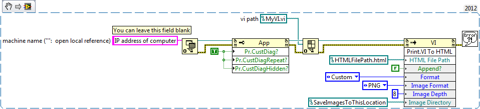

There is another property node called "Printing:Custom Diagram Repeat?" that, when set to true, will print the visible subdiagrams in line with the non visible ones, as frames. I have attached some code that will save your block diagram + front panel using this process.
You ask is there a property node that will only print the visible subdiagram as a frame without printing the hidden code? - the answer to this is no, you will have to print the full block diagram with all subdiagrams each time.
I hope this answers your question. If you have any questions about the code attached fire away!
Paul
