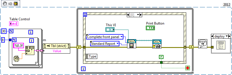

 Thank you for contacting us. I could reproduce your problem with LabVIEW 2012 (32bit), Windows 7 (64bit) and PDF Complete. As I've found, this issue is caused by the inconsistency in the way Windows 7 handles registry keys and access to the default printer in 32 bit and 64 bit versions. The problem is being addressed and fixed in a later version of LabVIEW. In the meantime, there is a workaround you can use, report generation VIs. This worked fine for me. Please try this Snippet:
Please get back to me with the result. We can also explore other options if this fails.

Hi, Andrew!
Thanks! I'm glad you could reproduce my problem. The workaround you suggest works on my Windows 7 computer. I've sent the application to my customers and now I'm excpecting their answers.

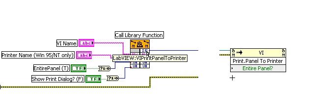

After checking the code of my main project again I found out that I use two different functions in my main project and in the project I have posted on the forum as an example. I have to apologize for that. In my main project I use Print Panel to Printer.VI which calls (Call Library function node) a function VIPrintPanelToPrinter. In my example I use Invoke node to invoke a method Print:Panel to Printer. The result is the same: it doesn't work in Windows 7 64 bit. But the functionality is not the same: calling library function let user open a printer dialog. User can select a printer and change settings of the printer.

Dear Ljubo!
I'm glad that it has worked for you, I hope your clients will have the same success. As I've found, incompatible printers on Windows 7 64bit is a known issue, and will hopefully be fixed in a later version of LabVIEW. I'll be sure to include your input (which printers worked and which did not) on the case.
Also, it seems to me that both the Invoke Node and the Library Call use the same function to accomplish printing; however, the Node sets the "show print dialog" input automatically to false, hence the lack of printing options (this makes sense from a programming perspective, since if we want to print programmatically, additional user input at every print job is most likely unwanted). Please get back to me when your customer has results, if something is still not functioning, we might explore some other workarounds.
