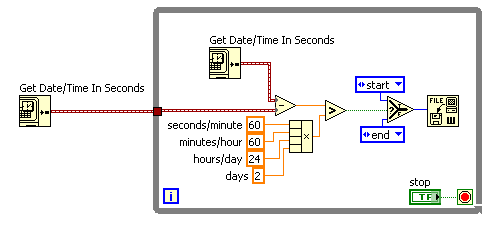

Hi liying,
There are different ways to determine ho much time has passed since the beginning of the VI. Here's just an example that does it using the "Get Date/Time In Seconds" function.

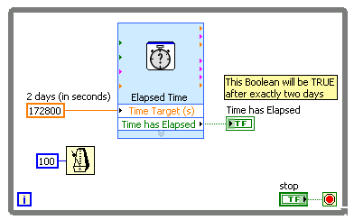

Hi liying,
Is there a reason that you don't want to use my example from my last port. Please let me know what your concerns are against using it.
Here's another more simple approach that uses an ExpressVI. Use the Boolean output to choose whether you want your "pos mode" to be 'start' or 'end':

Hi PhilipC.
First say sorry.Because I have some things some days before, so I see the leave word today.You said"Is there a reason that you don't want to use my example from my last port. Please let me know what your concerns are against using it."
The reason which I want to know another the example is I want to know more and more the method of the problem.you give me the first example is very well.Thanks for your help.
