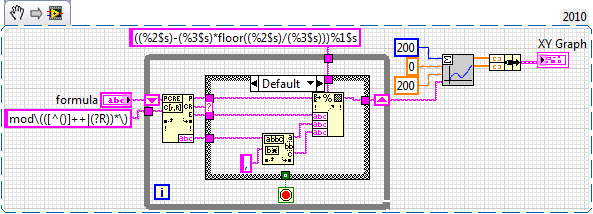

That function is not supported in the Formula Evaluation VIs.  In fact, no function of two variables is supported.  My usual workaround in similar cases is to use a little regex voodoo, in this case to replace the mod expression by its longhand equivalent.
You could also modify the Eval VIs to add the '%' function, which I did for the heck of it, but it is a jungle in there.
(3,033 Views)
aah - that explains it.  Thanks, and nice string parsing!
