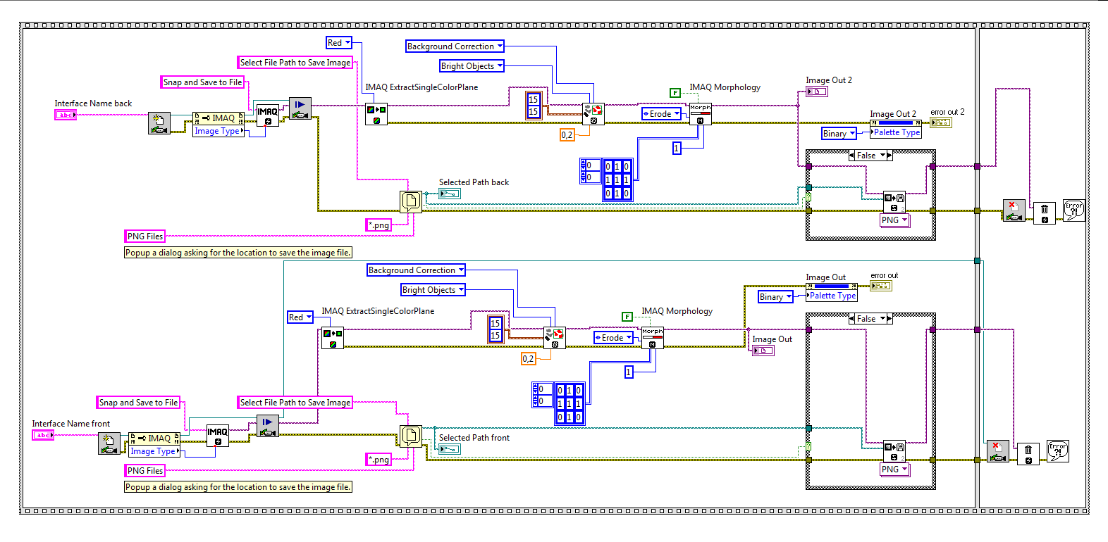

I tryed to make a code with Labview to process and save a picture.
I have 2 cameras, connected to a CVS, and I want to save only the red, so I created a Labview code to extract only the red with Vision Assistant, and I add this to the exemple call "snap an save to file.vi".
But when I tried to run the program I have the folowwing message:
imgSessionAttribute.vi loaded with errors on the target and was closed.
LabVIEW:  Failed to load shared library imaq.dll:imgSetAttributeFromVoidPtr:C. Ensure that the library is present on the RT target. Use either MAX to install NI software or FTP to transfer custom libraries to the RT target.
LabVIEW:  Failed to load shared library imaq.dll:imgGetAttribute:C. Ensure that the library is present on the RT target. Use either MAX to install NI software or FTP to transfer custom libraries to the RT target.
 What can I do for that?
I join the image of the program and the file

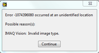

I tried the exemple call 'grab.vi', and it work, but when I tried to include my Vision Assistant programm I have the following error message
I think it it because I wired and "image out" to an "image Scr", but I didn't find any way to convert that.
thank you for your help

Hello
This is the "grab.vi" where I include the Vison Assistant vi
Thank you for your help
