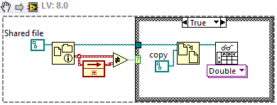

You can try something like this in a loop:
It looks at the file and when it sees its modification time changed (meaning something was written to it) it copies it (so that you don't touch the shared file) and then it reads the data from the copy.

tst Thanks for that quick reply.
would i do this in my producer loop? do i remove what i currently have in the case structure of the producer loop?
(3,715 Views)
