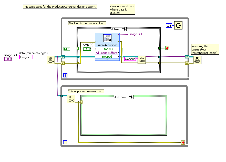

can someone please help me. I am totally stuck and lost. I am trying to build a procuder consumer architecture but the template from labview is not very clear. many books does not go over this concept.
i have created a vi. but i dont know what to do with the image in buffer.

One problem is that you created a queue that transfers Imaq references.  But in your consumer loop, you are transferring a string called elements.  (The red coercion dot on the Enqueue element gave it away.)  You would need to enqueue the purple wire.
On the other side you would need to dequeue the purple wire (Imaq reference).
One problem is that the purple wire is a reference to a particular memory location and is not a particular instance of an image.  As Mark was saying, you could wind up overwriting the memory location with new image data before you had a chance to do anything with the previous image data.

I don't see any red coercion dot on my Enqueue element.
This image highlights the coercion dot.
