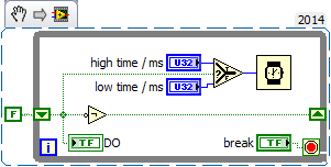

Hi Zel,
what's the problem with switching a DigitalOutput on and off with some delays in between?
Pseudocode:
repeat
  switch DO on
  wait (high time)
  switch DO off
  wait (low time)
until break
The same as snippet:
You will find examples with the example finder and by searching in this forum…
