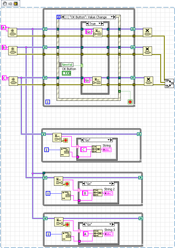

And this is what a producer-consumer system is for.  Trigger the sub-routines via queues or notifiers.  Here is a simple example

Jeff has given the best answer because it is scaleable.
Something quicker and dirtier is to put a case structure after the event structure but still inside the while loop. (Assuming your event structure is in a while loop.) The A and B event set a boolean to true. This gets wired to the case and in the event of true, the 3rd process starts. (Make sure to wire all other cases to a false boolean.)

I'm a bit uncomfortable with your solution.  Putting sub vis in events should be practiced with caution.  The event woun't complete until the sub-vi returns and the UI becomes unresponsive.  Same with the case structure outside the event but in the while loop.  you block the event structure from firing untill the case structure completes.  You could dynamically lauch a vi and set wait for completion to False- but it better be a reenterant vi so it does not block itself and cause the same problem (since the invoke node won't return until the vi launches- or it returns an error if it waits too long (Hmmmm what's the time-out? is there one?)
IM(not so)HO, It's much more desireable to disconnect the event and the reaction to the event with a P-C archetecture.
