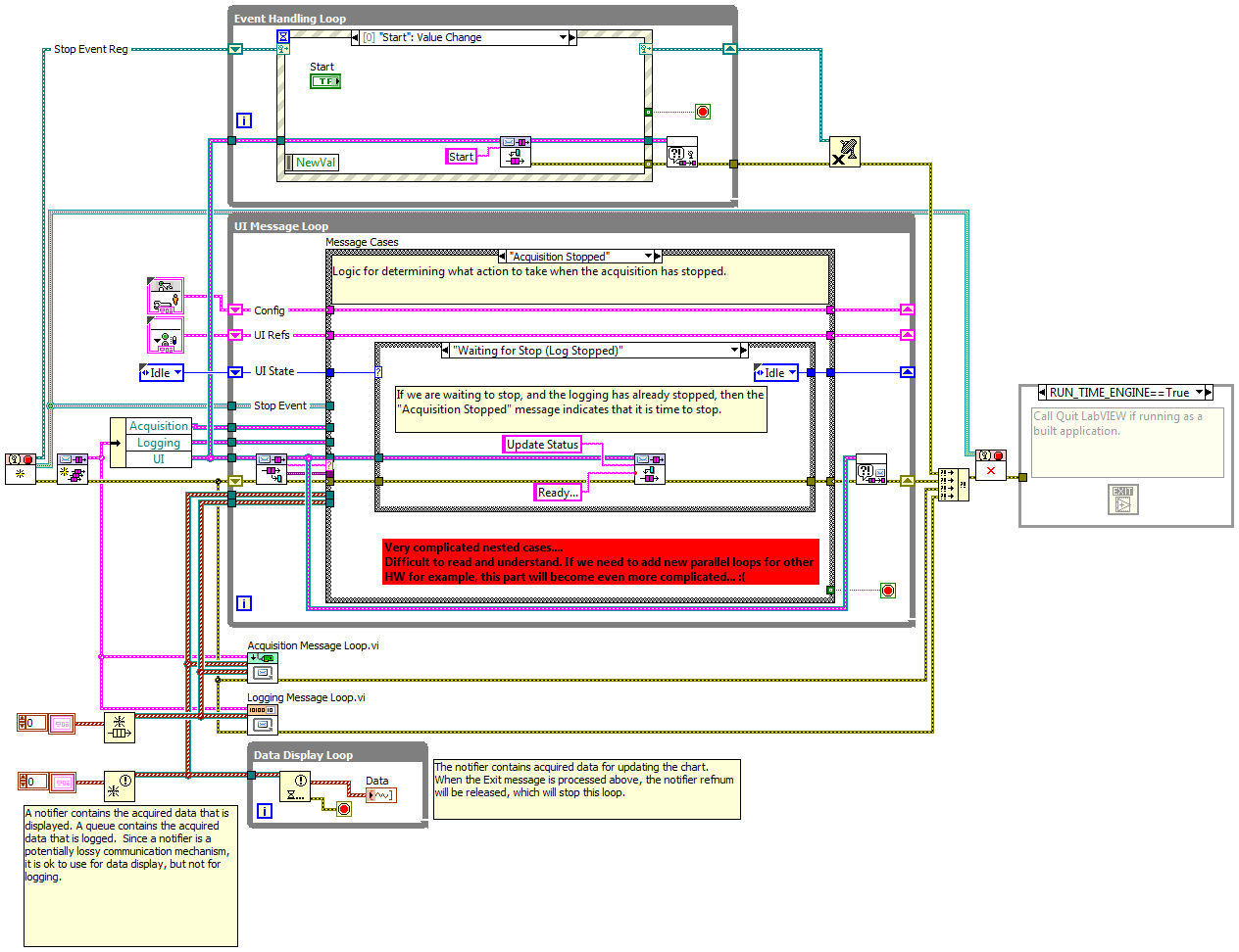

I am willing to learn good LV practices from the more experianced ones. Therefore I am asking about how you handle the following scenario. I often use a kind of queued msg design pattern with dynamic user events and queues to handle comm between loops. I do it similarly as for example in the "cont. logging and acquisition (daqmx)" design template. Last year i got the info from NI that they will create documentation in the close future, however as much as i know it is not done yet. I have a kind of feeling about that design it is somehow "patched", i do not find it elegant how the possible race conditions are eliminated in the msg handling loop (for example to avoid double hw init, etc.).
How do you solve these issues in your applications? For example nowadays i tend to use AEs which contains some state memory to avoid double init or close operations. Or it can also avoid the possible problem if there is still one more read HW state in the queue after closing reference (the AE ignores read request if the hw is already closed). Do you think it is a good practice to protect AEs in this internal way, instead of checking state status in the main vi? I find the above design template difficult to read with the nested enum checks in the gui msg handler loop. Are there better ways/ templates to use for such tasks?

Yea, sorry - I finally found it.  The version in 2014 looks a little bit different though. Perhaps NI finally updated it.
I'm going to preface this with:  I'm not exactly an expert. I have been working on learning design practices as well and this messague caught my attention.
OK, so looking at it, I'm not sure how you would run in to "race conditions".  The "UI Message Loop" and "Data Display Loop" are purely queue driven - which by definition can't have race conditions.
That having been said, I don't like this architecture for several reasons.
  • I find it bad practice to end loops with only error messages, because if you still have queued items they get lost when the queue is destroyed. In this case it is only data display, but if it was doing data logging or something...
  • It seems needlessly complex. A lot of the things they created a "message" for could easily be handled inside of the event structure. If you know your code is going to execute almost instantly, it makes no sense at all to send pointless extra messages for overhead. Especially if you already wrote a sub-vi to do this.
  • I prefer to use type defined enum constants for messages instead of text. The effect is the same, but it processes faster and you don't need to worry about typos.
  • I don't like the combination of the message handler and state machine. It again seems needlessly complex to me.
  • I don't like that one loop basically = the entire program. If something hangs or freezes or even slows down there (something that may be related to GUI control instead of acquisiton) you run the risk of buffer overflow happening and losing data. It just seems like a bad idea to me.
My method to do something very similar was as follows:
  • 3 loops - like they have.
    • "GUI" loop. This brought up all of my pop up windows, processed all of the GUI events, etc. It would send queued commands to the second loop to start / stop acquisition, setup hardware, etc.
    • Acquisition loop. This did all of my I/O, and PID. (program did acquisition and control).  This had (obviously) to be a tight loop for control and I didn't want it to ever have to worry about needless overhead anything.  Once data was acquired it would send a message down to loop 3.
    • Datalogging / Display loop.  This did all of the normal "overhead" for my program. Logged stuff to file, updated graphical display, etc.

Personally I recommend the JK I "State Machine" as a great design of a queued event handler, adding User Events to carry messages.  I am not a fan of the NI sample project for multiple reasons.   In fact, I redid "Continuous Measurement and Logging" (2012 version) as an alternate sample project available after one installs my "Messenger Library" (it will be available as "Messenging: Continuous Measurement and Logging" if you install "Messenger Library").
