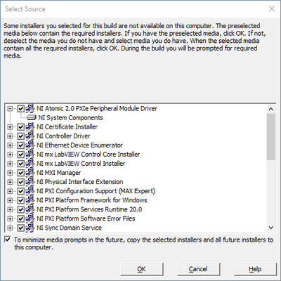

Yes, there are a ton of packages in that location, and I'd have expected there was a cache somewhere, but I get this dialog when I try to build my app:
All I have selected here is the LV2020 64-bit runtime engine and DAQmx 20 runtime. I tried giving it both the package directory you linked and \ProgramData\National Instruments\MDF\ProductCache and it didn't accept those locations.

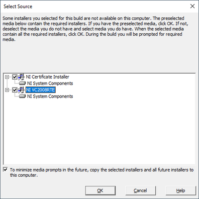

OK, we're getting close! With the clues that it *should* use cached packages, and doing some poking, it looks like my LV2020 installation was done via NIPM but my DAQmx was done via some other method that I can't recall.
Removing the DAQmx runtime installer let me build an installer, so I did a "repair" on my DAQmx installation via NIPM, which successfully cached its installer. Now I have a much more limited list of "additional media":
It seems I have those things installed on my machine, but *not* via NIPM. Progress!
Also, it appears the installers are cached to C:\ProgramData\National Instruments\MDF\ProductCache.
