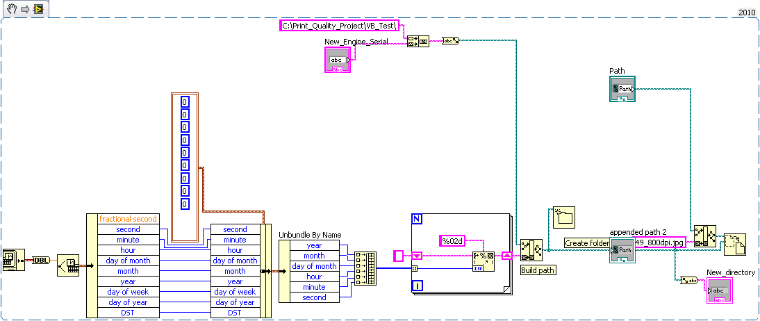

I still don't see the problem. Create folder just creates a new subfolder, but does not wipe any other subfolder.
For instance, if I have a folder "C:\Machine#123\201208271210" and use "Machine#123" again it will create a new subfolder "201208271220" but will leave the "...1210" folder there.
I'm not sure what the move function at the end of your code is supposed to do, but this should also not delete previous directories.

Hi
Some curious questions:
Why are you using the unbundle, bundle and again unbundle functions? you are finally getting the same time and date details in the first cluster as in the second!  you could have directly taken the data from the time and date cluster directly!
You have an appended path indicator overlapping the appeneded path control. What is the path written into the appended path control?
Are you sure the folders are deleted? Are they being moved to the path in the 'appended path' control?
Regards

Hi Splee and Freelance,
to take the unbundle/bundle dance even further:
- why do you convert the timestamp to DBL before converting to time cluster?
- why  do you use all that functions at all, including a loop to convert the numbers into string? There's a function "Format Date/Time string" that will do all those functionality with just a proper format string:
You should be working with real path controls/constants instead of covnerting to/from string all the time...

Oh Yes!
It would have been far easier to format the timestamp directly, than all that manipulation.
