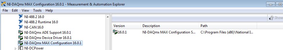

I am attempting to install a cDAQ-9181 chassis into NI MAX on a Windows 7 Machine which has LabVIEW Runtime and NI MAX installed. However, when I right-click on Network Devices in NI MAX, the "Find Network NI-DAQmx Devices" menu item does not appear. Am I missing some component of NI MAX?
I have installed the NI-DAQmx Device Driver 16.1. I have updated my cDAQ chassis to the latest firmware. I can see the chassis in the NI Network Browser. I ping the chassis from the Windows command prompt. I have run the NI Update application to ensure that all installed software is up to date.  See attached files for screen shots of NI MAX and NI Network Browser.

your DAQmx is missing MAX Configuration
Thank you Jeff for the quick reply and solution.
I found the DAQmx with Configuration driver, downloaded it, and installed it.  Everything is working fine now.  When I opended NI MAX, it automatically found the cDAQ-9181 card and displayed it in Network Devices.

Maybe you installed only the Runtime?? I only had to install the full version to install everything.
Compare: http://www.ni.com/download/ni-daqmx-16.1/6424/en/
With: http://www.ni.com/download/ni-daqmx-run-time-engine-16.1/6426/en/
