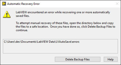

Another day, another crash... This time it asks to delete backup file 😮
Looks like LabView autosave/backup function does not really work.

Hi Alex,
It asks to manually backup files out of this autosave folder to allow you to (try to) recover them later on your own.
Isn't that a nice feature of LabVIEW?

@GerdW wrote:
It asks to manually backup files out of this autosave folder to allow you to (try to) recover them later on your own. Isn't that a nice feature of LabVIEW?
Absolutely it is a nice feature!
But the message is confusing, it says "delete backup files" which indeed it does not do, it just relocates them. Thank you for explanations GerdW, I wish it would be your short sentence as a message instead of that scary one.
