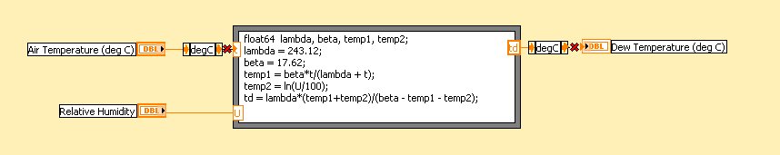

Another request of behavior change for the "Remove QD".
In this example, I changed my mind and removed the units of the temperature control and indicator. The unit conversion functions thus became useless and broke the wires connecting them to the formula node:

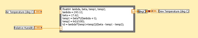

If I select the unit conversion function and Ctrl-Space Ctrl-R it, here is what happens:
I suppose this is just one possible example of an "intended" behavior, which is not exactly what would be expected by the user. I mean that you can probably imagine a number of situations where there is a single wire going in an object and a single BROKEN wire coming out of it (or reciprocally) and the expected behavior of Ctrl-space Ctrl-R would be that both pieces of wires are connected (or at least a connection is attempted if that makes sense).
