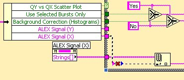

Here is my starting point:
The two string cluster outputs used to be enums, which I converted to strings for added flexibility.
Now I do not need anymore to extract the corresponding enum "string", which I was doing with the little piece of code at the bottom: take the string array from the property node for the cluster element and index it with the value of the enum (code which is now replaced by a string connected to an array index, hence the broken wires).
I was anticipating that a Ctrl-Space Ctrl-R (CSCR) on the Index Array primitive would remove said primitive and figure out that what I wanted was a direct connection of the (broken) string wire with the output string wire. Fat luck!

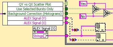

Instead, I get this:
All wires are removed and no connection is made. Of course the same happens if I do that with the remaining Index Array.
Is there a way for CSCR to do what I was expecting? There is a single ouptput and a single input wire with a compatible type...seems like a no-brainer 🙂
