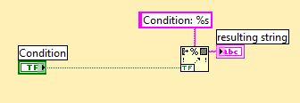

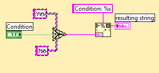

The solution is in fact to select the two constants AND the Select node. Then CSCR does the proper job:
Screen Shot 2014-10-13 at 17.16.55.png==== CSCR ===>Screen Shot 2014-10-13 at 17.17.10.png

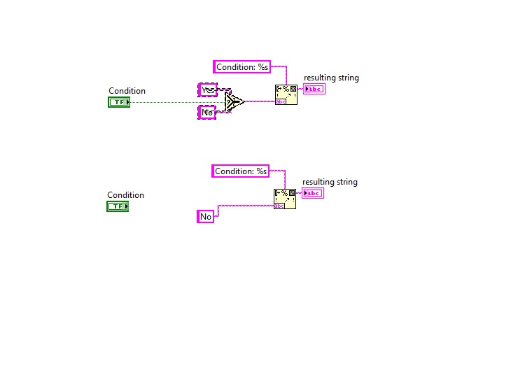

Not in LV2010. Smiley Sad It still leaves the 'No' constant connected.
- Partha ( CLD until Oct 2027 🙂 )
Message 83 of 120
(1,403 Views)
In LabVIEW 2012 and later (sorry parthabe), Ctrl-Space-Ctrl-R will remove *every* selected wireable object, even constants and control terminals, then it will try to figure out how to wire up what's left. I added this functionality because of discussions way up in this thread, where we were brainstorming how to make Remove and Rewire smarter. Unfortunately, there are cases (like this one) where my scripting code just isn't smart enough to figure out your exact intentions based on wired terminals and data types alone. Because of this, I made the change to remove all selected objects (regardless of wiring arrangement and data types) so you can give LabVIEW a clue as to what you want to happen. In this scenario, all non-nodes (Control Terminals and Constants) are removed *first*, then the wiring of the remaining nodes is calculated. That's why selecting the constants and the Select node gives you what you want in the screenshots above.
