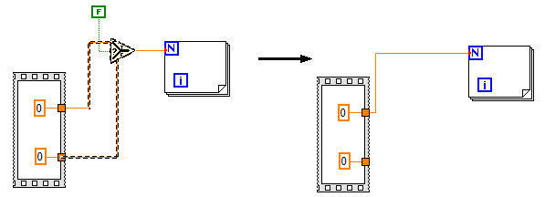

Here is a case of CSCR doing something I am a bit disappointed by:
Screen Shot 2015-08-19 at 17.31.53.png ===> Screen Shot 2015-08-19 at 17.32.08.png

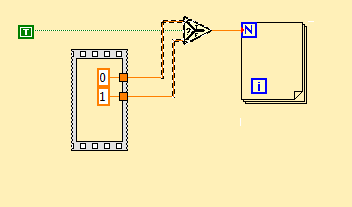

when "of course" I was expecting this:
Connecting the Boolean wire to the For Loop iteration number doesn't make sense, I agree with that.
However, connecting the single blue wire would seem natural, as it is the only other source.
I agree that if the Select primitive had had more than one source wire, there would have been ambiguity.

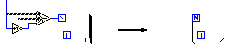

Screen Shot 2015-08-19 at 17.39.39.png===> Screen Shot 2015-08-19 at 17.39.51.png
So what gives?

Hi X.
I'm not sure what you are asking.  Are you asking if the number of iterations is wired, or why the number of iterations is wired to 1?

X. wrote:
So what gives?
The Remove and Rewire algorithm gets incremental improvements with each LabVIEW release. I'm not sure which version you're using, but in LabVIEW 2015, the operations appear to behave as you desire:

@Darren wrote:
X. wrote:
So what gives?
Cool. One more reason to schedule an upgrade. I tested this in LV 2013 SP1.
