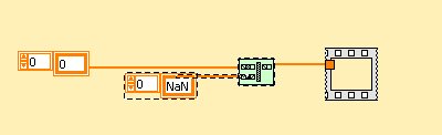

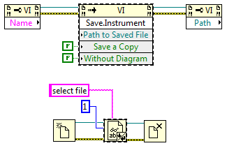

In my series about Ctrl-Space Ctrl-R (CSCR) unwanted features, here is another one:
In the snapshot above, I use the OpenG Filter Array.vi as an example but I suppose it could work with other VIs (it does not work with all though!).
I wanted to remove the VI and of course I first tried selecting it alone (not shown above) and CSCR-ed it. I got the following result:
Wrong! Of course I wanted to keep the input array (the original VI made more sense that this dummy one).
So I tried to select the VI AND the Filter array and CSCR-ed them.
Bummer! The result is the same as that shown above...
Why?
Message 23 of 120
(2,022 Views)
Remove and Rewire will try to remove any constants wired to the removed item (that aren't wired to anything else). This is intended behavior, and I argue that most of the time, it's desired behavior.
At the same time, Remove and Rewire will try to preserve any pass-through wires (that's the whole point of the feature in the first place). So in your illustration above, these two features sorta compete against one another...one of the constants is kept to preserve pass-through data, but the other is removed. As for which one survives and which one doesn't? The order of terminals on the removed node determines that...the constant wired to the first terminal in the list wins (i.e., doesn't get deleted), and it looks like the OpenG VI's connector pane orders terminals in reverse.
As for how to fix your problem while maintaining current functionality...how about I loop through the constants wired to the soon-to-be-removed node and de-prioritize any of them that are selected? So when you lasso the item you want to remove, also lasso any constants you want removed as well. I'll move the unselected constants to the top of the list in terms of pass-through preference, so that, if something needs to stick around to preserve a pass-through, any constants you selected will be at the bottom of that list. What do you think?

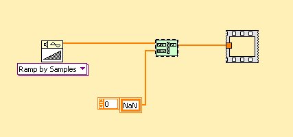

OK, I guess I simplified my diagram too much. Try this:
CSCR yields:
If I select the constant and the VI and CSCR (see below), I get the same result...
None of it makes sense and I don't see what conflict there could be for CSCR to get it wrong, but it does nonetheless!
As for cases with only constants, I think your workaround would do the job, but please look into the case above...

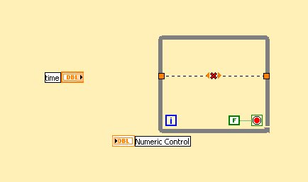

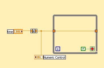

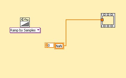

Not sure this one has been discussed yet, but here it is in a few snapshots:
Now I select the unit conversion object and CSCR it. Here is the result:
Sure, the wire would have ended broken if kept connected. But is is ALSO broken when not connected. Maybe I did not notice the Numeric Control and would have cleaned the problem myself later?

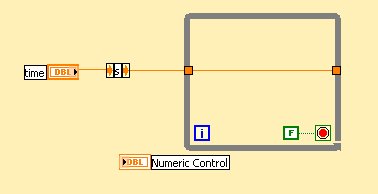

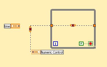

This being said, if I disconnedt the indicator:
and try to CSCR the unit primitive:
This is not very satisfactory either...
Message 29 of 120
(1,964 Views)
I think in your last example it comes down to the datatypes of the wires.  It only connects wires across the removed node if they are the same datatype.  Think of boolean array to number function, it just deletes the node and doesn't try to connect the boolean array wire to the integer wire because they don't match.
Now you might think in your example that since the wires are both orange going into and out of the conversion node, they match and should be joined.  But they are not the same datatype.  One is a double, the other is a double with the units of seconds attached to it.  If you tried to wire across after the node is removed, you'd see you have a broken wire.
Message 30 of 120
