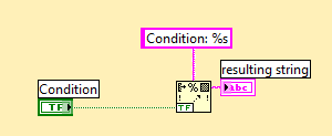

Maybe a new one for your consideration.
I have (re)discovered that a Boolean can be connected to a Format to String node when the expected input is a string, resulting in a "TRUE" or "FALSE" string.
Therefore, whenever I have a chance, I clean up old code of the form:
The problem is, when I CSCR the Select node, I get this:
whereas I obviously want that:
Message 75 of 120
(1,873 Views)
Obviously you want the second thing?  That makes no sense.
You go from wiring a string into a Format into String, where the format string itself is looking for a %s.  And you think the replacement should suddenly be a boolean going in?
Message 76 of 120
(1,868 Views)
I am not saying it is natural. Just that this is what I was hoping for.
Message 77 of 120
(1,866 Views)
If it isn't natural, it's not exactly fair to call it obvious.
Message 78 of 120
(1,849 Views)
It'd be hard to set up rules for that function. As it works, it'll match the current string input of the Format to the left objects, matching a string constant. Prioritizing controls and also considering dynamic input possibilities sound very advanced.
In this case it'd be easier to just delete the Select and wire Condition instead of using the Quick Remove.

QD cleans up the constants for you.
I ended up deleting the node and manually removing the constants.
