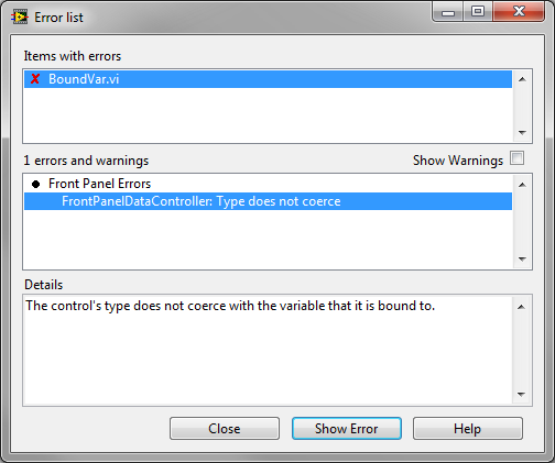

I have an NI 9213 (thermocouple) module attached to my CompactRIO. I created a VI in my PC target and tried to bind a numeric indicator to an I/O Alias of one of the thermocouple channels. However, my "Run" button became a broken arrow and LabVIEW says, "FrontPanelDataController: Type does not coerce." and "The control's type does not coerce with the variable that it is bound to."

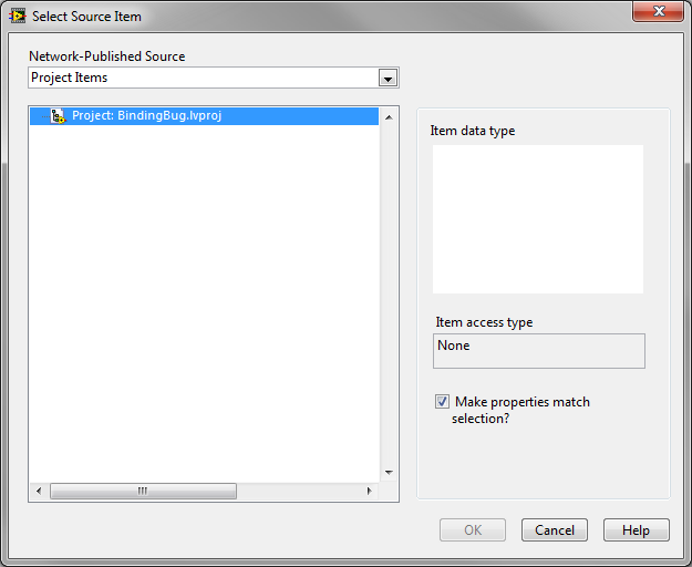

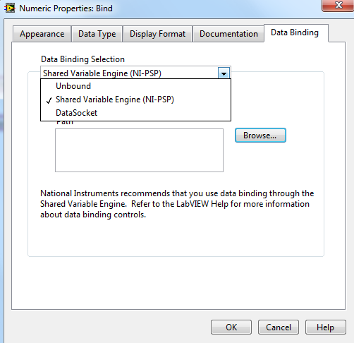

Other weirdness observed: In the indicator's Data Binding properties page, if I select "Shared Variable Engine (NI-PSP)" and click "Browse...", I cannot browse for any variables in the project. It shows the .lvproj file, but none of the modules or libraries. If I manually type in a variable's path, I get the error message; if I type in an invalid path, the indicator simply becomes unbound.

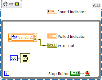

The project and VI code are very simplistic:

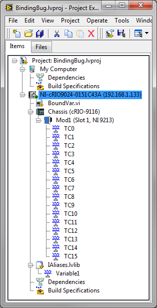

I want to bind an indicator to a thermocouple I/O variable/alias. This page says I can drag the variable from the Project Explorer to my block diagram, but LabVIEW won't let me (the mouse cursor shows a "forbidden" icon). I've previously bound controls/indicators to Project Items before, but now none will show up: (The screenshot below is supposed to show my chassis, modules and variables below the .lvproj)

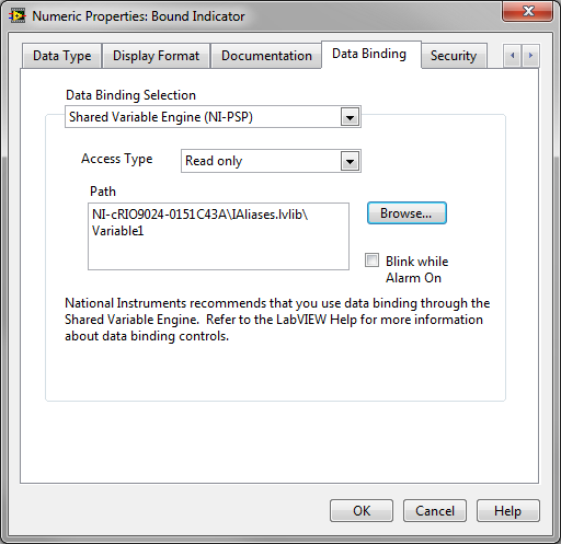

So, I manually type in the address:
...and then get this error:
I've attached my whole project. How can I fix it?

My screenshots show that I'm already trying to bind to an I/O Alias: NI-cRIO9024-0151C43A\IAliases.lvlib\Variable1 (which should show up in the "Select Source Item" window, but doesn't). Any other ideas?

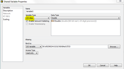

This sounds like expected behavior to me.  The IO Variable you were using doesn't look like it uses PSP to pass data.  This is needed to use that bind to data option in your project.
Here's what you selected to the IO Variable.
Below is the address of the variables, notice there's no reference to psp.

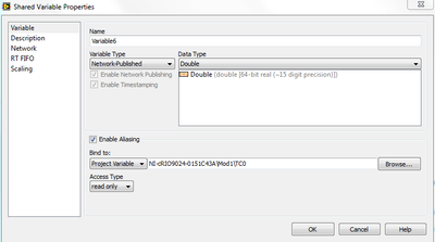

Below is how I would suggest performing this action.  Make a network published shared variable, enable aliasing to the IO Variable of your choosing (in this case TC0).

Thank you very much for your detailed walkthrough. You hit the nail on the head: My previous project indeed used Network-Published Shared Variables with aliasing enabled -- I remembered wrongly and thought they were I/O Aliases instead. Following your steps allowed my indicator to bind to the indicator.
