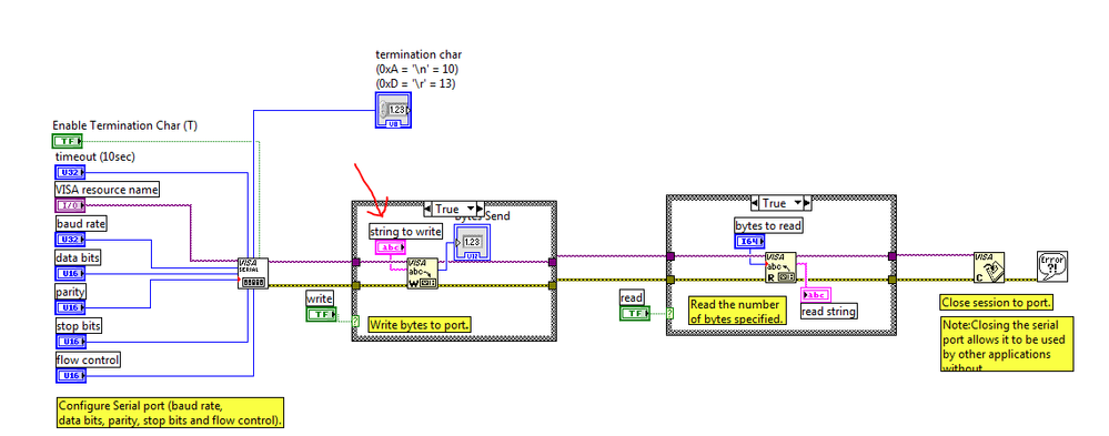

It doesn't work. I have changed the .vi as it should be but it doesn't work well. My hardware is ok because I checked with hyperterminal and with a SW provided by ICP.
Maybe is my block "string to write" that doesn't send what I think i'm sending?my vimy vi

You didn't but the termination character at the end of the message you are sending.
Change the "string to write" to \codes display.  Add \r ad the end of it.
For style points, in your block diagram, move the terminal for the termination character over to the left.  You have your wire running backwards.  In the image it looks more like an indicator than the control that it actually is.

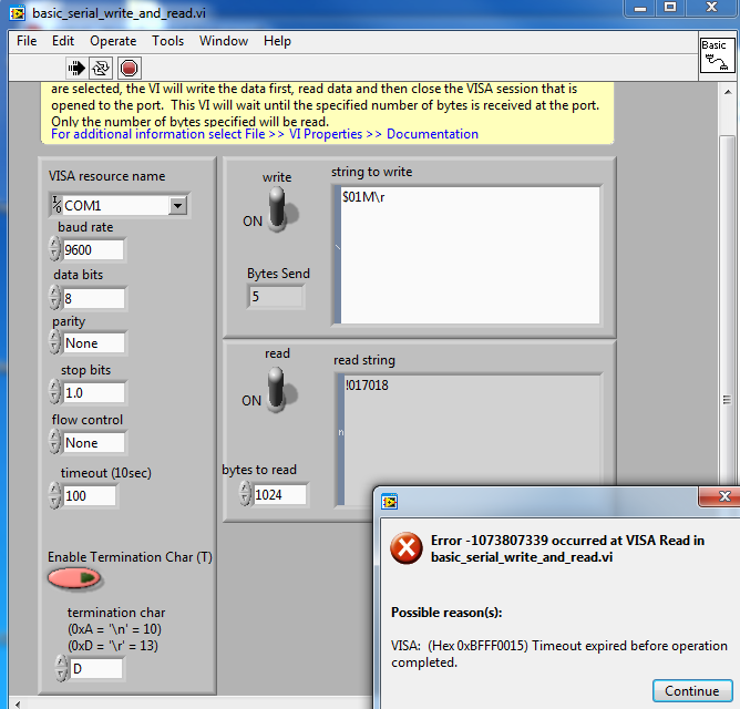

OK now it works!!!
So the problem was I wasn't using "\ Codes display" in my Write string.
Now i get the answer and timeout error (but i think this is because of the "Simple error handler" block. I will get rid of it and thats all.

Your Enable Termination Char (T) boolean is set to False. This may be the reason that you are still getting a timeout expired error. Try setting it to True.
Message 17 of 18
(2,716 Views)
You know I didn't even notice that because the weird pink color had me thinking it was pressed.
