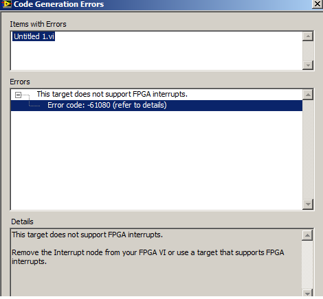

after that this error appear to me in compilation process
This mean that the Spartan 3E does not support interrupt operation in labview fpga
I was suppressed .....Do you now why because I learn from LabVIEW FPGA Training Spartan 3E that Spartan support this operation

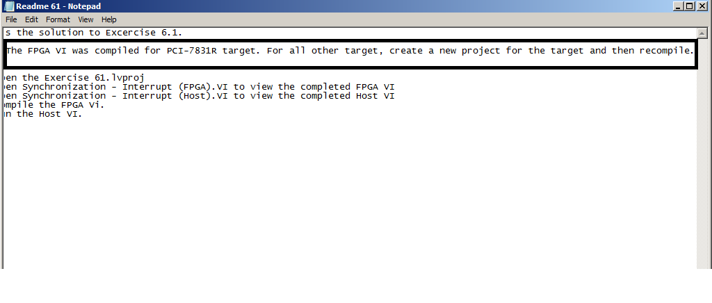

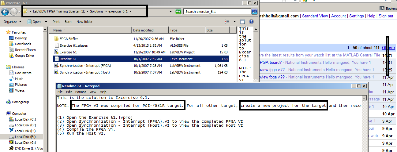

Oh you can see in tutorial the completion was for pci not Spartan and the tutorial for Spartan !!!!!!!!!!why this why
in same figure
note what he say ""another target "" this mean for example ""spartan""
why this conflict

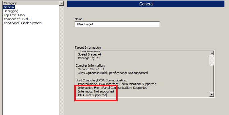

Regardless, the 7831R device does support interrupts, so if that is the device you are compiling to, you should not be having a problem.  To determine whether a target supports interrupts, access the FPGA Target Properties dialog box and locate the Target Information section of the General page.  For instance, on the Properties page for the PCI-7831R, I see "Number of Logical Interrupts: 32"

As you have already discovered, you cannot use IRQ synchronization for these targets. There are mechanisms that you could use to ensure that there is some synchronization between the two sides of your application, for example using the fact that you can read and write to either a control or indicator and do so from either the host or the FPGA. For example, you could do the following:
  1. From the host, write a control to "tell" the FPGA to do something.
  2. On the FPGA VI, wait until the control changes to your expected value that you wrote in 1.
  3. Once you've done something on the FPGA, to indicate back to the host that something has been done, change the value of the same control in 1. (or it could be a different control/indicator)
  4. On the host, once you've done the work in step 1., have it periodically check on the control (or a different control/indicator) to be changed by the FPGA to indicate that some work has been done
This is a simple synchronization mechanism known as "polling". Unfortunately, due to technical limitations in the communication interface between the host and the FPGA for these targets, interrupts are not available to use.
