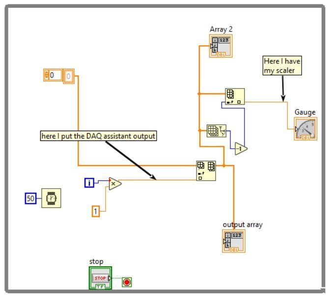

problem is : now I need to use shift register and math operations between them, and I have this error :
The type of the source is Dynamic Data.
The type of the sink is double [64-bit real (~15 digit precision)].
I jointed my code, you can see the error in the bottom of the block diagram
Does somebody knows how to fix that ? Like converting the dynamic datas into numerics ? I tried the unbundle function, doesn't work

This is one of the reasons I HATE the DAQ Assistant and the accompanying Dynamic Data Type.  The DDT abstracts the data type and makes it extremely easy to confuse the data.  I recommend you immediately turn the DDT into either an Array of Scalers or a Waveform.  Then when you trace the broken wires, you will find that you are mixing scalers (single values) and arrays/waveforms.

I can convert it to array yes, but why not into scalers directly :
like this :
I can only take trial in 2 weeks, will it work you think ? with a continous acquiered signal ?

Is there a reason you are collecting 100 samples at 1kHz rate, but only care about 1 value?
Do one of these three things.
1.  Try 1 sample at a 10 Hz rate.
2.  Use a From Dynamic Data Type which is an express VI you can configure to give you an array.  Then average that array.
3.  Use a From Dynamic Data Type which is an express VI you can configure to give you a scalar.
