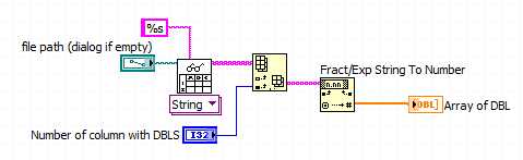

WNM,
Why use a for loop when you can convert an array with a single function?

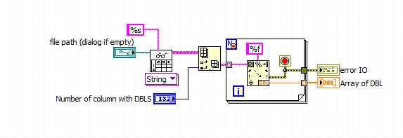

You mean like this?
Frankly because I did not know that those conversion funtions would work on arrays as well as individual values.
But now that I do know, I'm not sure I'd use it anyway because the FOR-loop method gives you a level of error checking and reporting for the string-to-numeric translation that the single conversion function does not offer. You can feed the single function any manner of garbage and the only hint of a problem is that some or all of the resulting DBL array will be zero. The FOR-loop method will report a conversion error for the same garbage.
