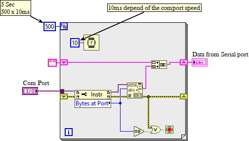

Benoit
(2,641 Views)
Of course this is not your main VI but it will read all data available on the serial port.
Now add a loop for every 20sec... a GUI...

Thanks for the help. I red the data insist while loop and no data at port then exit that while loop and pass the multistring into different while loop until empty string to exit the second while loop
(2,596 Views)
You should not rely on the bytes at port for reading data. Your protocol should use a termination character, fixed data size or have a packet header that indicates how many bytes to read. Using bytes at port will eventually cause you problems as you will read the wrong amount of data at some point and your data will not be synchronized after that.
