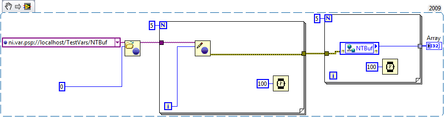

LabBEAN wrote:
Are there any caveats for "Write Variable" in the new API?
 The write performs more as you would expect.  In this case.
The output array from the Shared Variable node is as follows:
  4,0,1,2,3
The reason the first value is 4 is because this was the value of the Shared Variable before I ran my test and therefore is the first value in the network buffer.  The rest of the values were the ones added to the network buffer in the first For loop.  If I were to run out the second For loop for 10 iterations instead of 5 the output would look like this:
  4,0,1,2,3,4,4,4,4,4
  4,0,1,2,3,4,4,4,4,4
In the past "warm-up" reads have been necessary, but this seems to persist into subsequent write-read calls.  I ran the following code to put elements 0,1,2,3,4 into the buffer, read them out, and then repeat:
The results were 4,0,1,2,3 both times:
 Is this a bug, or am I missing something?
