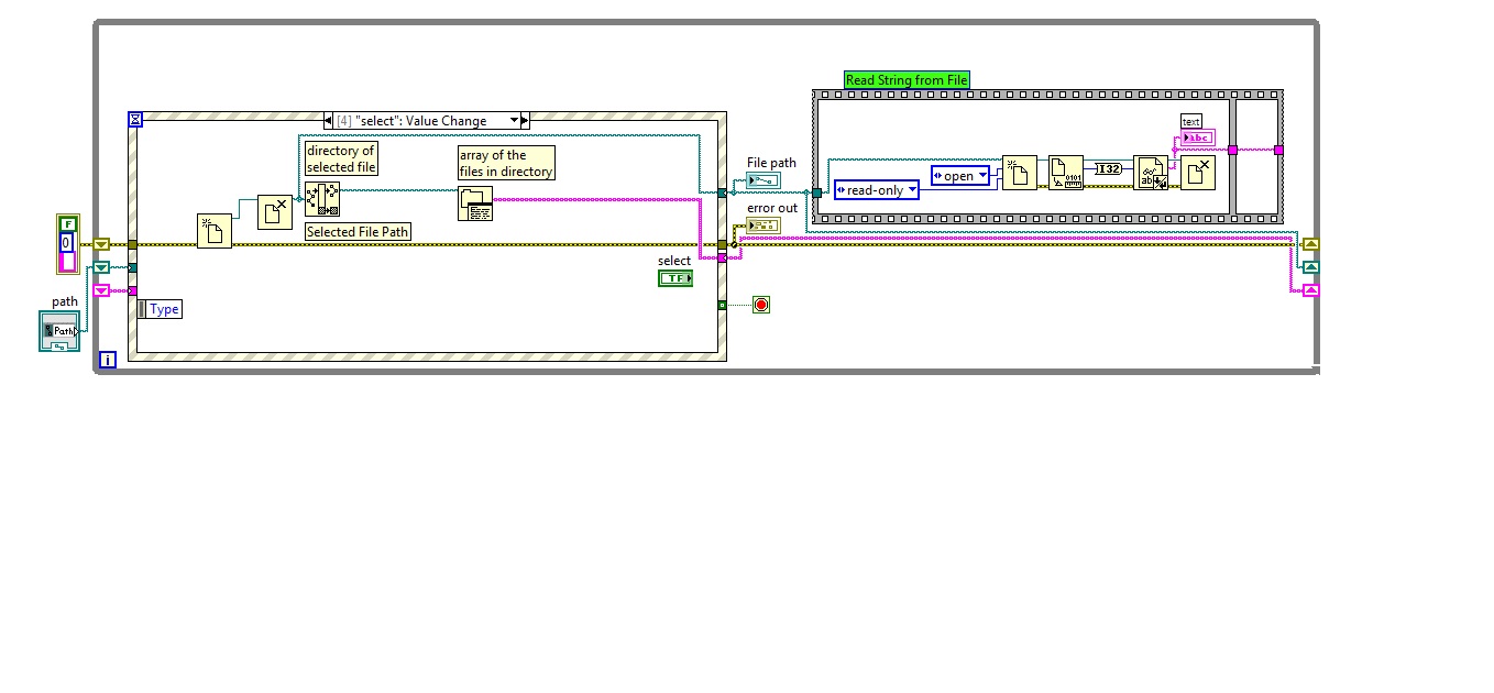

thanks for reply but it doesn't work I have attach here vi

Hi kalu,
don't know what you're trying to do:
- you have a "path" control but you don't use it for ListFolder...
- you get an array of filenames from ListFolder, but you don't use that data later on...
- you are using "OpenFile"/CloseFile to get a file path (in the event) and later on you use that path to read data from...
Your original question doesn't has anything in common with those things you do now...

Hi Kalu,
I also could not follow your question. Can you descirbe us mor detailed what you want to do?
