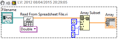

Hello, I do not understand why the Express VI does not function here, but I strongly recommend to avoid using Express VI and the "evil" dynamic data type here (not useful and hiding information).
Just use a spreadsheet VI, like this way, you get directly what you need:

Thank you for your help Blokk. It works perfectly now.
