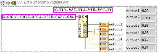

Hello, i might need your help regarding this matter.
I'm current taking a reading from Arduino from 2 accerolmeter to Labview. X=0.02 Y=-0.03 Z=0.99 A=0.33 B=0.42 C=0.84 (Example)
But when i display them using Waveform Chart in labview, I need to use the array to count the position of the String from buffer which sometimes might be inaccurate due to the the value extracted.
I was told that i can use Search string from the beginning to allow the waveform to take in only the numeric.
Are you able to assist me regarding this issue?
Below attached are the pictures..
Message 8 of 11
(14,426 Views)
Jim
Message 9 of 11
(14,397 Views)
