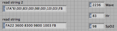

1. That graph image does not look like the values on the chart are going to zero. It looks to me more like a low value of a few hundred.
2. The "read string" indicator shows the last character as \FB which is supposed to be your termination character. The VISA Read does not include the termination character in the output string, so something is not working as expected.  I do not have the time to set up a special serial port test to try to emulate your system.  Were the termination character controls set before the program starts running?  The defaults values will not set the port the way you want.

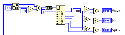

3. Your string conversion does not appear to match the protocol specified on page 4 of the sensor document.  The Number indicator is not displaying 2236, which is how I would interpret the protocol for the values in read string. I have never seen a protocol like that. I do not think any of the standard string to number conversion functions will do what you want.
This code will produce the results described in the protocol.
