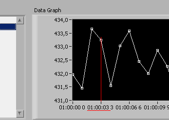

jack47 wrote:
You can right click on the grapg axis and select 'formatting'.  In the pop-uo select absolute or relitive time, add the 'container' and then select what you want to display.
i allready tried this option but it brings an incorrect result.
maybe you mentioned that with this option, every value in the graph gets a time of 1 second.
for example, the fourth value is at 01:00:03 (red line).
but in the txt-file the voltagevalues have a space of 4 seconds inbetween. so the third value should have a time of 12 seconds (cause first value starts at 0)
but thx for first reply!
Message Edited by fr33k on 09-16-2009 03:21 PM
