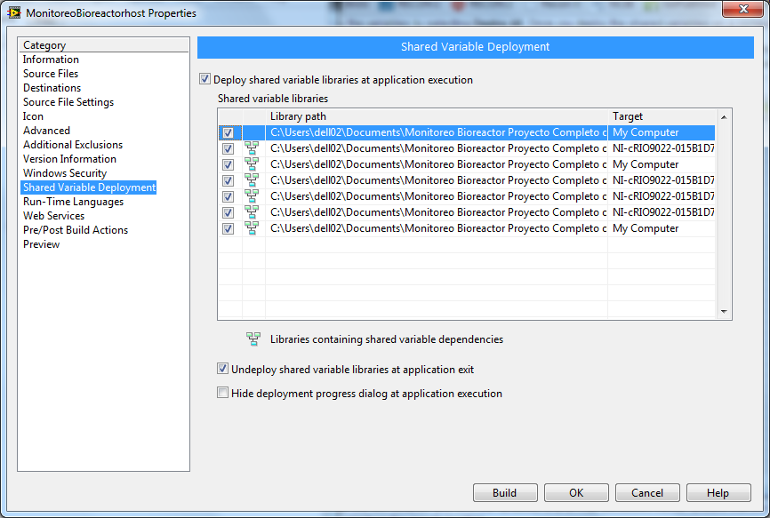

Thnks Omar R.
yes we are missing some configuration but i don't have idea what is it.

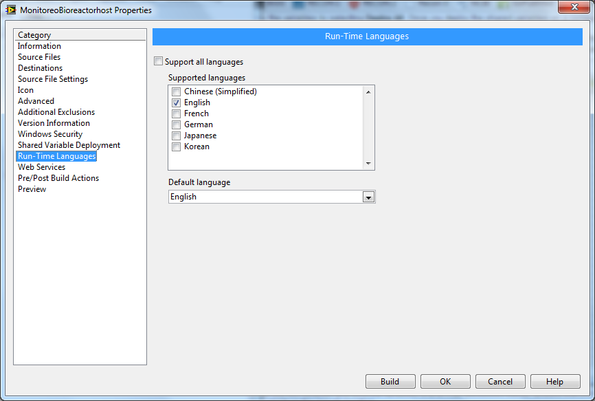

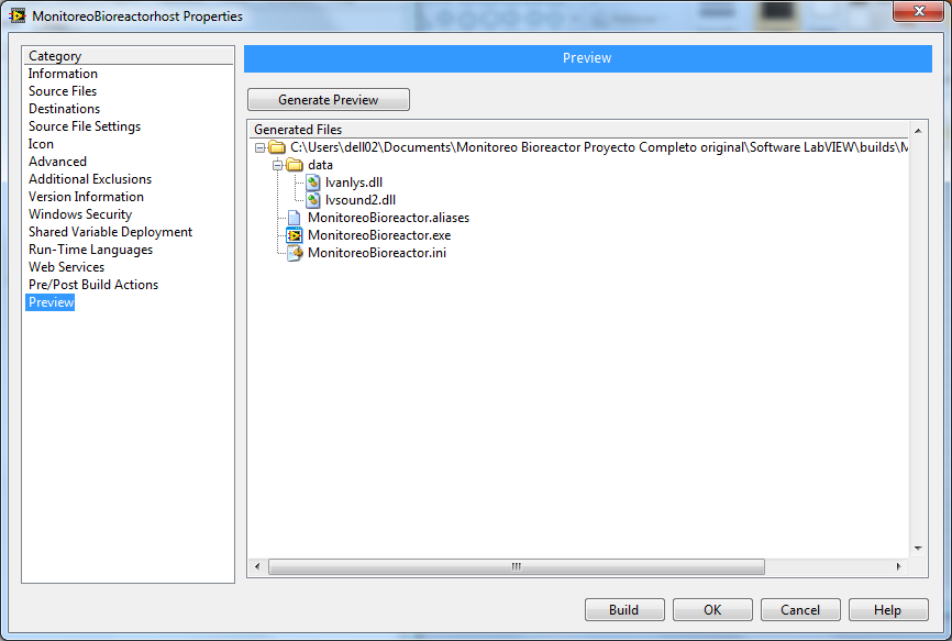

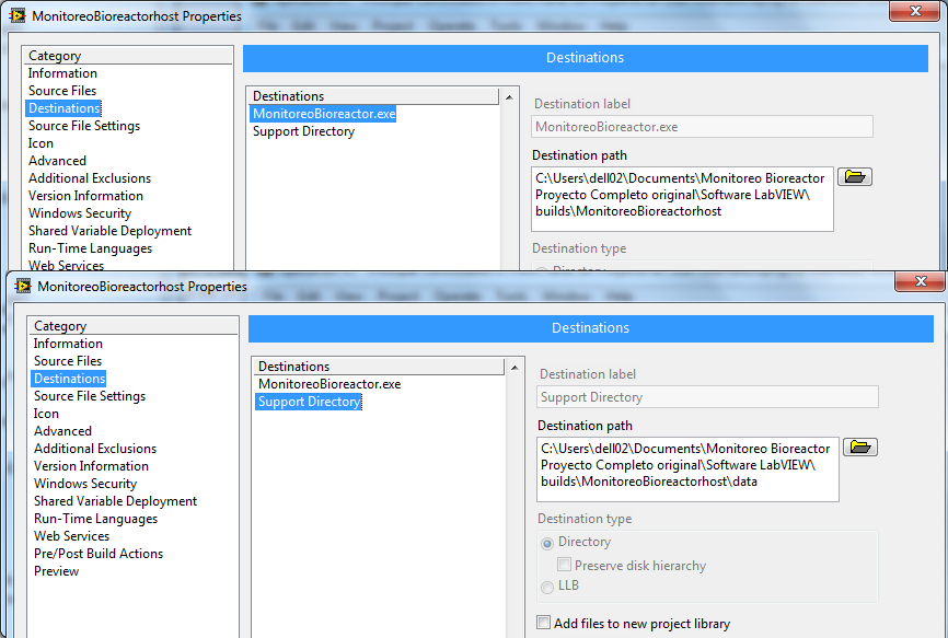

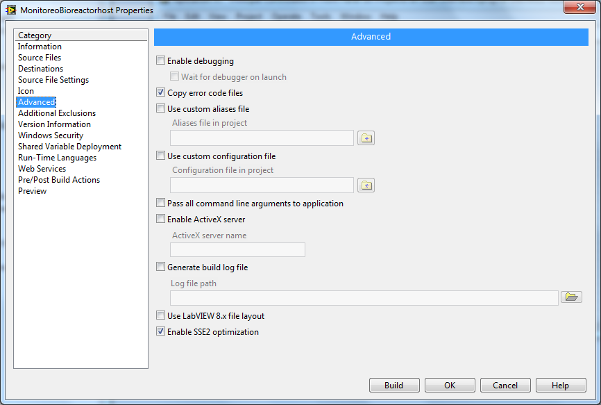

i followed the first link to deploy network variables but this doesnt work when i run the exe, and then when i gonna run the principal.vi since labview i get the next error
Possible reason(s):
LabVIEW:  (Hex 0x8BBB0005) Unable to locate the shared variable in the Shared Variable Engine (SVE). Deployment of this shared variable may have failed, the SVE has not started, or the SVE is too busy to respond to this request.

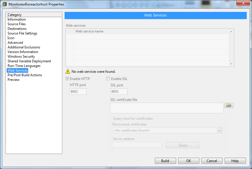

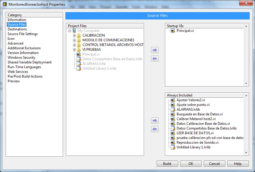

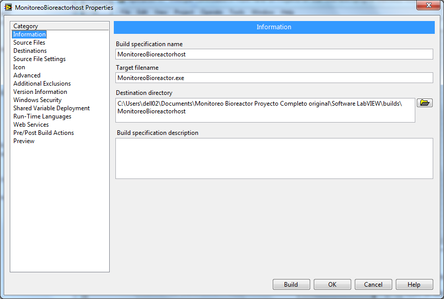

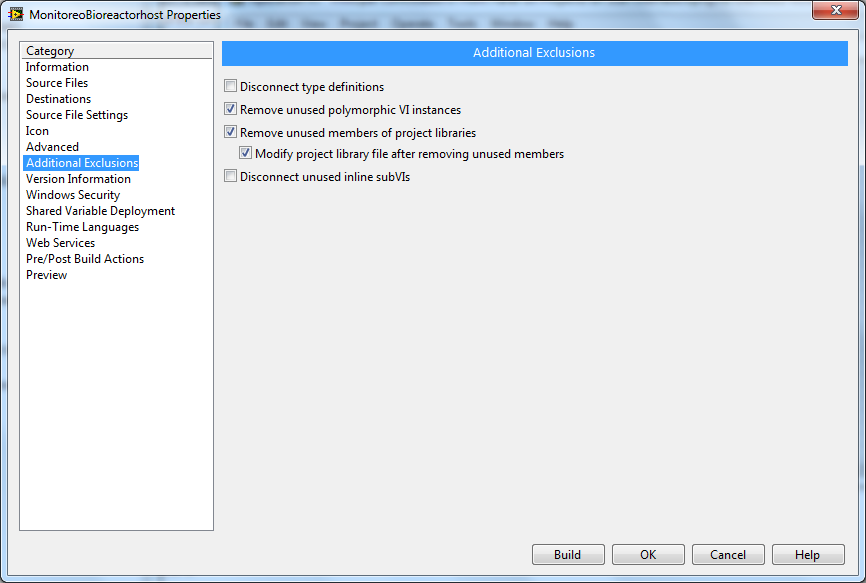

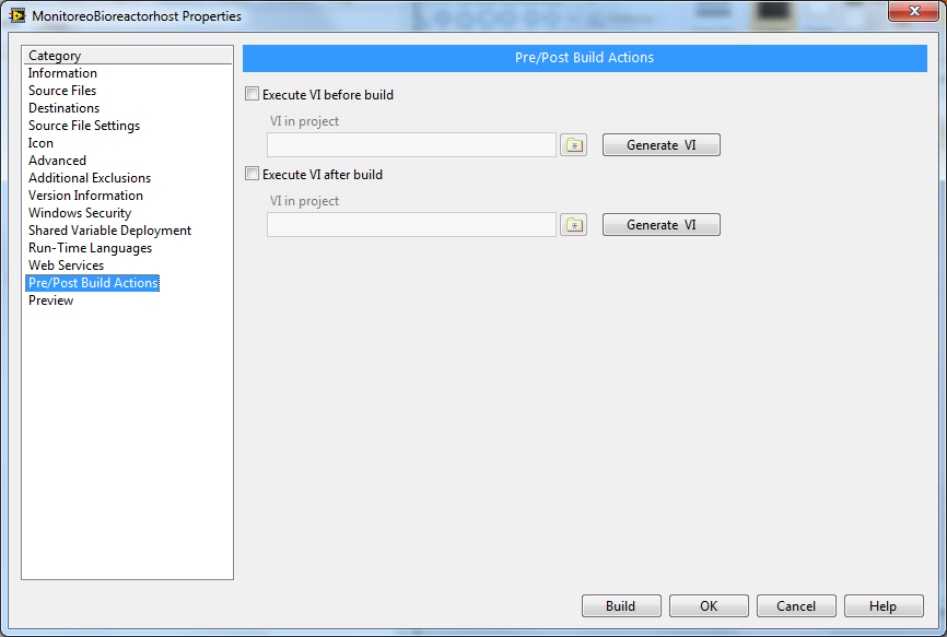

i post you all the configuration windows about the .EXE
2host.png3host.png4host.png5host.png6host.png7host.png8host.png9host.png9host.png10host.png11host.png

Hii MonicaDiazT
I
 notice that the RT application network shared variables libraries are different from the ones you are including in the Principal.vi EXE. Is there a reason for that ? If you want to share data between both applications, you need to include the library in the RT application, do the deploy and then read it those variables in the host.vi. These variables must be the same. I also notice that you´re including the .lvlib into the Always Include section of your build. That´s not entirely necessary.
What you can do is to start over and follow all the steps, but working with a less complex project. First you can open a new project and create a library with network published shared variables with one or two variables. Then you can create a simple read and write VI which will be our RT application. This RT application will read and write values to the network published shared variables. Then you build and deploy this read and write RT application to your target. Also, you can create a simple host.vi that monitors the shared variables. Once you realize you can monitoring the variables, you can build the EXE. If everything works with this simple project, then it will be easier to you to notice what you are missing in the other project.
